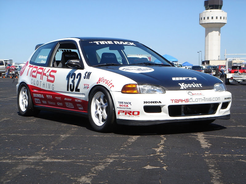

Minumum Weight Calculations:
All listed weights are without driver.
2 Seat FWD: 1650 + 125lbs/liter
4 Seat FWD: 1550 + 125lbs/liter
The Civic would be 100 lbs lighter than the CRX, assuming the same displacement engine was used.
Doesnt matter... there is no way the HEAVIER 4 seater civic will make the lighter minimum weight lol
An ITR swapped CRX has a realistic min weight of 1875lbs
An ITR swapped EG has a minimum of 1775lbs and would be lucky to break 1900...
My car is currently ~2100lbs with no power steering, I will be absolutely thrilled to be sub 2000lbs with power steering added.
The CRX is smaller and has a shorter wheelbase.
So my point stands - if you didnt care what you were driving, why wouldnt you be in a CRX? Personally, I'm in an EG because I cant stand CRXs

If you are trying to make min weight, why do you still have metal fenders, hood, and doors, and glass windows?
The min weight is lighter on the Civic. Just because you can't get there, has nothing at all to do with it. People have put Integras under 2k lbs before...
Besides, you originally said CRX compared to an EF. An EF can make min weight with an ITR swap (though I would argue that an ITR swap is the wrong engine for the class).
